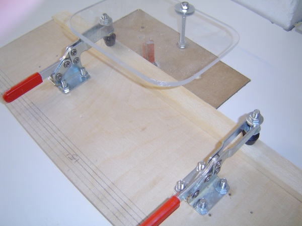

My simple brace radiusing jig was roughed out then sanded in my dishes 25' one side 15' the other. I use it with a table router. But I still finish off the braces by sanding in the dishes.
PostPosted: Thu Aug 23, 2007 9:26 pm
Todd, do you have a source for upcut (for router table) spiral flush cutting bits with bottom bearings? I have only seen flush cutting spiral with bearings mounted on the end of the bit.

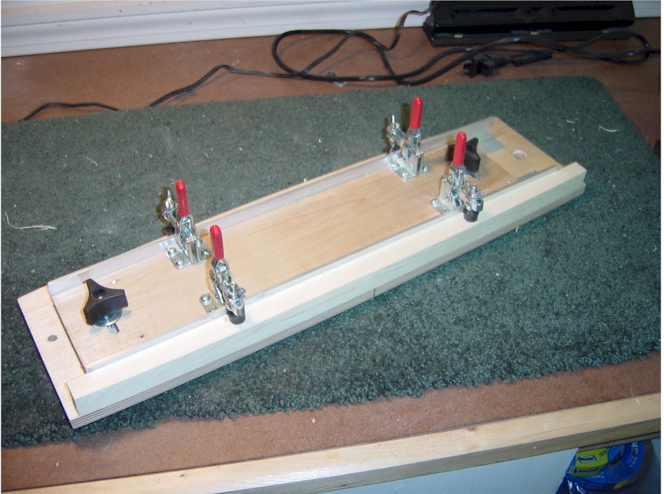

Here is the jig I use for radiusing my braces.

Thanks everyone. I think I am going to make a jig similar to the ones posted
by Colin and Mark. I guess I will just make a template using my radius
dishes and transfer that to the jig, so I can rough cut it from there and sand
it to smoothness.
Colin, do you just unscrew and reverse the clamps when using the other
side?

Yes, I make up a batch of 25' blanks, undo the bolts turn it round and do a batch of 15'. I've been meaning to make another one for years so I don't have to, but somehow it's never seemed to be worth the time.
